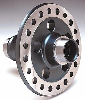

Excuse my ignorance, but what is a spool?
A spool is a solid diff (carrier) that takes the place of a limited slip unit (Sure Grip) or an open diff. The ring gear bolts to it and then the axles are installed and then everything is locked up. No differential action what so ever.

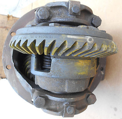

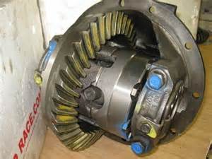

So far so good with my factory posi, I'm somewhere in the 500hp area and it leaves nice posi burnout every time haha. I learned something new helping Kahn search for a posi at the Nats, you want the old clutch style posi because the newer cone posi's aren't rebuildable. The cone digs into the housing so when it's done it's done, you can spot this style by looking threw the opening where you'll see a plate and springs inside.
O'K cranky just posted at the same time and it appears you can machine them but the older style is just a simple rebuild. These guys know more about it than me but I'm pretty happy with mine so far.
This is the cone style
This is the older clutch style
