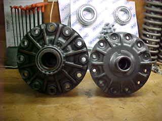

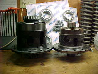

Yup been machining them for a long time now and the first one I did was over 25 years ago.
Here's the difference between a clutch type 8 3/4 and a Dana 60
Even tho the Dana 60 weight about 50 lbs more on average, I think they are worth it but there's a lot of people running hard with the 8 3/4 too. My level of pucker stops around the low 11 second range with a 3600 lb car and for sure if it's a 4 speed.
