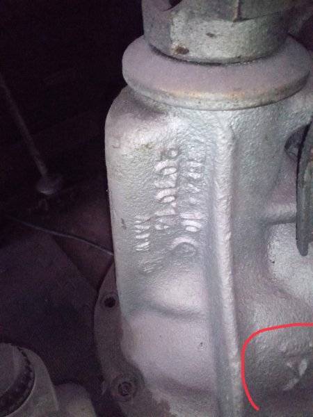

8.75 rear .
Ronald Weishaar
5:44 PM
Oct 18, 2018
280
109
cashtown.pa
With number on the case 207074. There is no 1 or 2 following the 74. Can anyone give me any info on this rear. It has a 3:91 sure grip
The early part of the number puts in the date range similar to a 742. My bet is it's a truck rear 1 3/4 pinion.
Doug
The last digit is missing. Look for a big X or a 2 cast into the side of the housing. X is 741 and 2 is 742.
Cannot see anything after the 4
You have a 741 see the big X at bottom right.
next is a 742, big #2 there.
Thank you 413 I was focusing on the number. One of those deals that you can't see the forest for the trees
Thank you 413. I was focusing on the number. One of those deals that you can't see the forest for the trees
