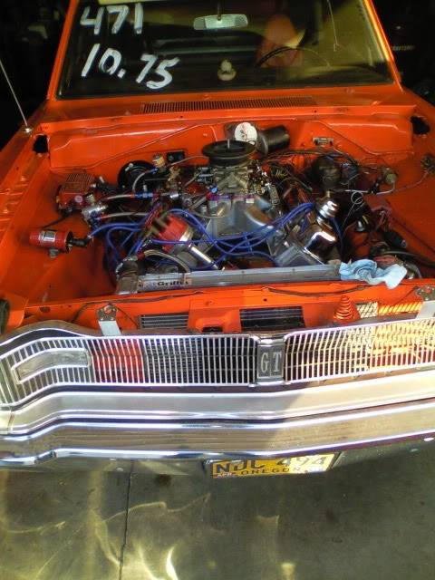

Holley 750 dp
11.2 comp

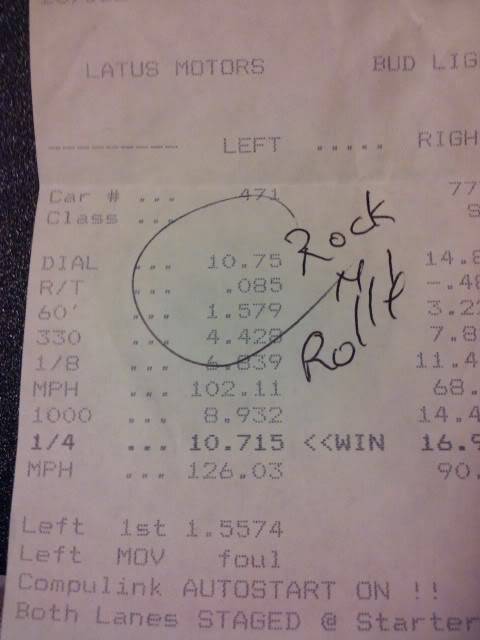

Runs 10.71 off the juice and on pump gas.
