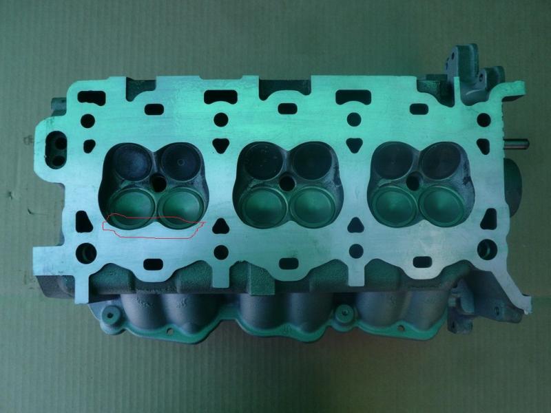

And the Ford Duratec head. I circled the quench pad in case you can't figure it out. It's always the pad opposite the exhaust valves to help generate a "push" towards the exhaust side. For the record, both that Nissan engine and the Duratec are still being made. Modern quench multi valve technology. You should do more reading and learning and less arguing. I hope you know more about drive shafts.....but honestly, I know where I WON'T be takin my driveline business. lol

You really aren't so great on the topic as you think you really are.
1st if you had a clue you would know that 4v heads don't really rely on quench or swirl but do really on velocity, squish and TUMBLE, tumble swirl is used as the charge comes in to the opposing cyl wall and then reverse tumble across the piston face and be forced to the center of the chamber still in tumble.
They DO NOT use quench as you so want to believe they do, since the small pad on each side concentrates the area across the center as squish and not quench, and not to the exhaust valve like you so want to believe, it is a small concentration to the center and not at the plug, the piston forces the charge to center of the head , quench in a multivalve could cause turbulence and hurt the fire since it will blow across it and is no where near the same as in a 2 valve wedge design where it concentrates the turbulence to the chamber and at the plug and pulling heat as quench, in a multi valve head it simply makes a little turbulence but it does not act as quench since it can not direct its force to the center of the head and defined spot in the chamber.

Well, there really isn't any difference between a 'squish' area vs 'quench' area. They are both the same but many call the quench area a squish area. What does quench really do? According to Mr. Erb, "it kicks the burning flame front across and around the cylinder at exactly TDC in all cylinders," and yes, that's happens right after the plug fires. And btw, Rusty isn't 'my' professor.

I agree. I could have gone without usin all of the snarkyness, I guess. All I did do was point out quench pads on cylinder heads and on pistons. It's up to everybody else to believe what they are....or not. I mean really, a blind man can see the quench pads on that Escape piston. What more does it take? Quench was a good thing back in the 50s and 60s. All manufacturers did was refine and tune it, just like everything else. I'm no expert on quench as it's new to me too......however, I've done enough reading and asking those in the know that I can recognize a purpose built quench engine when I see one. Those two modern examples I posted are quench engines.

Quench is to cool, quench is the ability to lower the temp and prevent detonation and move the initial event to happen closer to td than before it creating more torque by not wasting it as a lost explosion btd. The more timing, the worse the burn, the less effect of quench the loss of power and more chance of detonation
Squish is the area between the piston and flat surfaces of the head, and that is squish, squish is a turbulence to better mix or swirl or swirl and tumble to create a better more complete mix which burns more efficient and clean. quench is the effect of pushing the mix into the flame front and not allow it to burn at the back end but explode by feeding it at the front which reduces timing and builds more torque and lowers exhaust temp since the complete burn is now a explosion in one exact time across the pistons entire face or crown and not to the side, or in one area of the piston and chamber but uniform on the piston and chamber.
Squish is in all motors, some have bigger areas of squish and others have minimal amount of squish, quench is the design of directing or feeding the squish in one direction to cool or slow the burn, the examples another has put up is just squish, there is no directing to quench it it is simply squish, squish doesn't make quench it makes turbulence.
