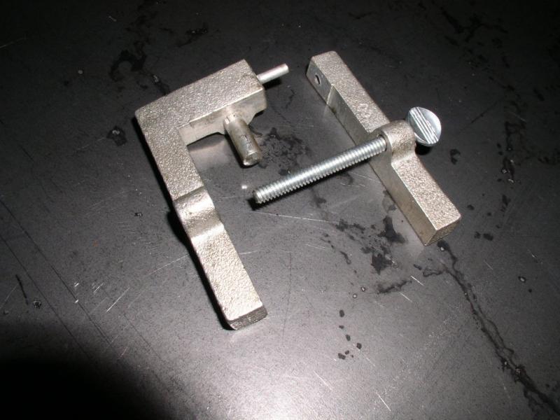

5.7 hemi has you steered in the right direction. Check out this original Chrysler tool I just picked up. Probably has some collector value lol.

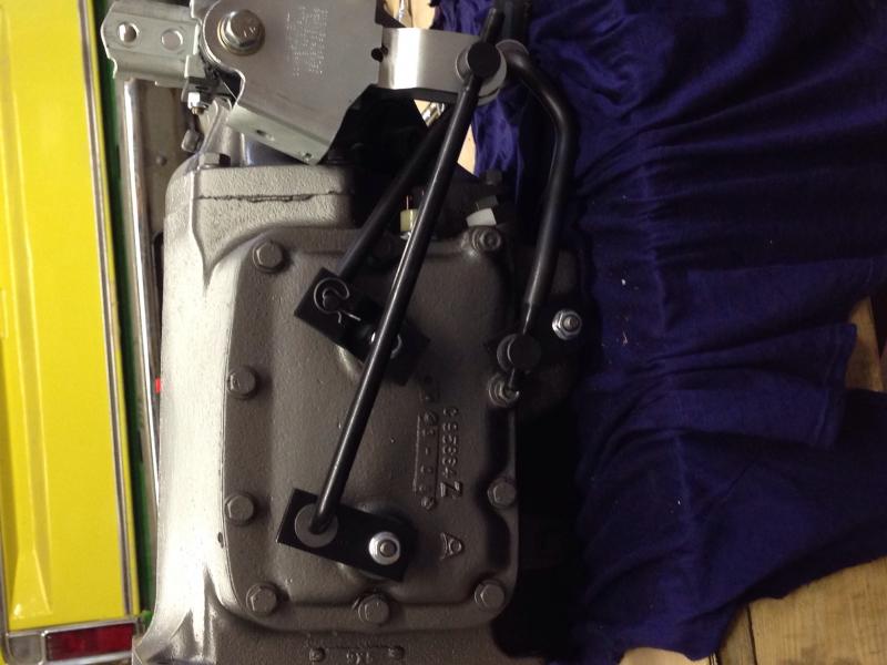

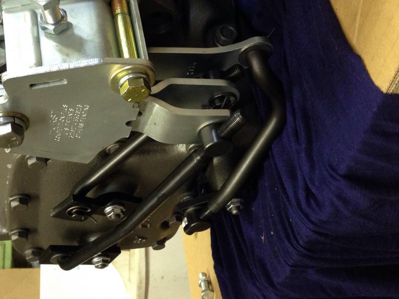

Hope it looks right. Other than the sideways pic lol

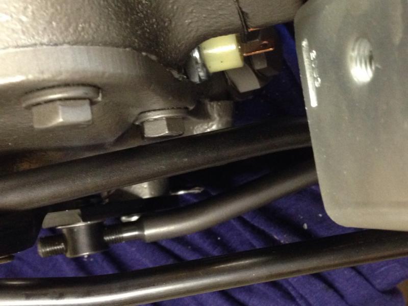

The middle rod supposed to be this close to the cover nut? Its just touching itimage.jpg
IMO, functionality should be fine as long as it don't rub and bind on you going to 2nd. If it binds you'll need to do something.
Some possible options...
You could shim the shift adapter plate or the shift mechanism out.
Swap the pivot washer to the spring clip side. Find a hardened .010" washer to replace with on the rod side.
Use a thinner washer under the cover bolt.
It will likely conflict with the 3-4 but for grins check if the rod will work on the other side of the 1-2 shifter tab.
More drastic measures are bend and grind.
