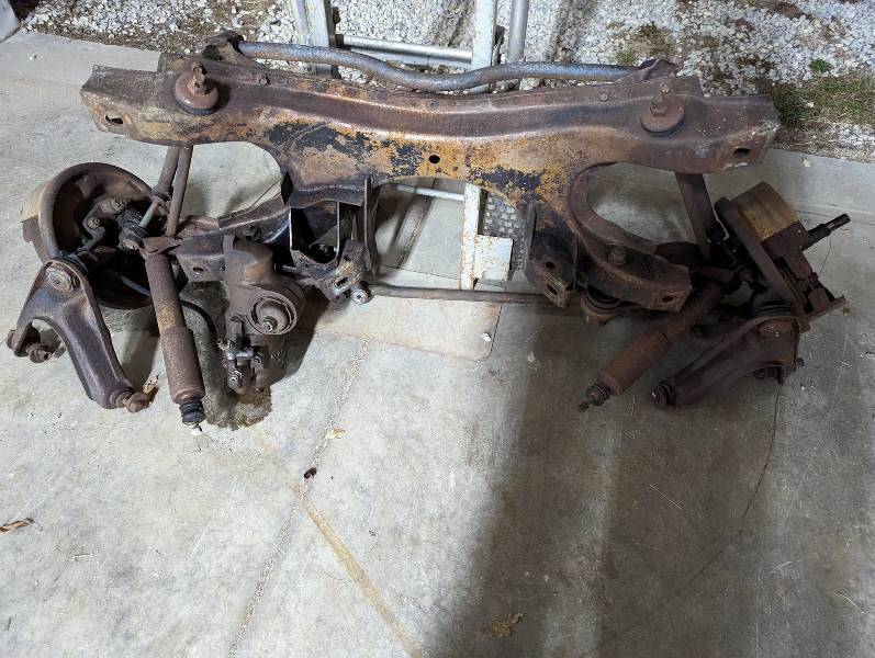

It's disassembled right now...1 of the 2 did go thru the K member ...I THINK it was the R/T ??..I'll have to dig & lay them out with their control arms n K members on the floor to make sure
Where is your sway bar mounted? Post a picture maybe. If for whatever reason yours sway bar is mounted in front of the k-member you’ll likely have to rear mount the calipers.
these are not mine but these are the ones I have that are disassembled ... the location & size diff is evident
The larger one came on the red coronet avatar pic...a plain jane 318 auto with 8.75 Truetrak with small drums ???
Not sure what you're asking, but for swaybar sizes put a 7/8 or a 15/16 wrench on them to figure out dia

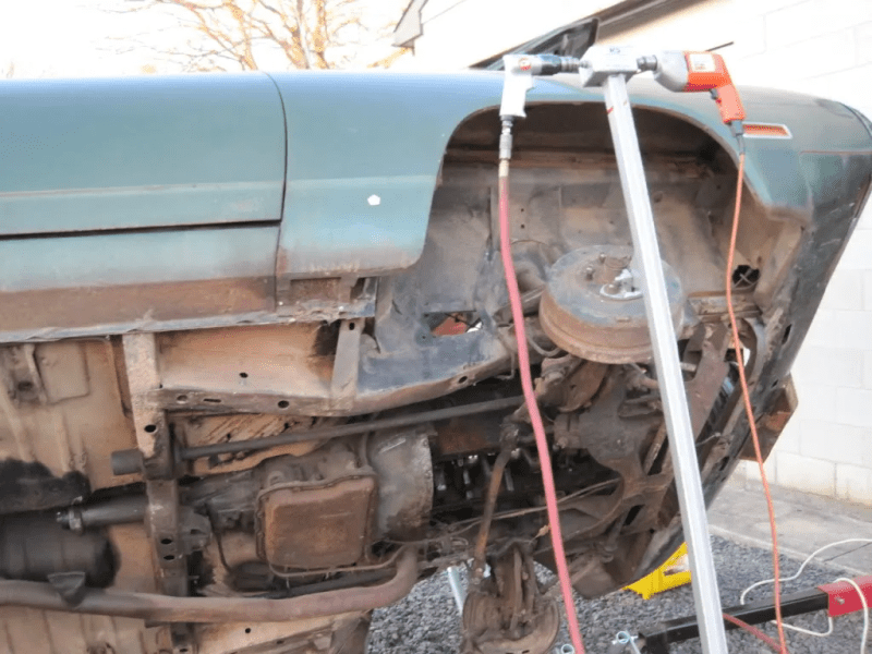

The crunched off h pipe is interesting on the 70
