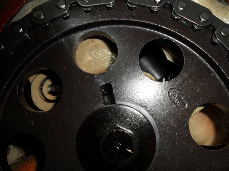

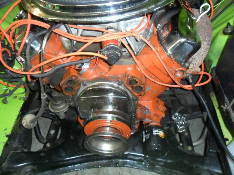

I decided to try some checks and tune exercises, including lighter dist springs to bring the advance in earlier and that helped some, but was not enough. So some time later one day after a couple hour drive and the near home requisite putting it through its paces, I hurt something as it lost some power and was making a metallic tinking noise. Got it home and started doing some checks. Pulled the modified distrib since it suspect since I had touched it, but it looked ok. However, while checking I noticed that when I was turning the crank with a socket and breaker bar the distrib was not moving in sync.
I started pulling it apart and this is what I found.

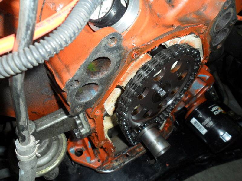

I understand a 50 year old car has likely gone through several owners and a lot of mods even though the car may not have that many miles driven. I'm guessing the motor was "freshened" some time ago, likely 10 or 20 years ago based on the age of the gaskets; with an overhaul gasket, bearing, timing chain kit. Unfortunately it was a standard kit, with a standard, though US made, timing chain, but that wasn't the main problem. When I got the timing cover off I could see the timing gear looked a little wonky and when I checked the cam bolt it was loose. After I took the chain and gears off I found the cam gear had been loose and the cam pin had worn through the back of the gear. Close inspection showed no evidence of any thread lock on the cam bolt.
So, its a bad news, ok news thing. After ordering a double roller timing chain, I decided I should keep on doing some checking and pulled the pan to check the bottom end for torques etc. Found forged pistons and balanced assembly. While it was running it never lost oil pressure, and I was keeping a close eye on the gauge after I noticed there was something wrong. After installing the new chain, bolt and an application of thread
lock, I did a compression test and got 175 to 180 for all, so I called it worth moving on without pulling the heads. Got it back together and it runs good.
Think you were right on time finding that issue, that could have become a major disaster if not found.
Just to confirm i understand what happened, due to the cam gear bolt being loose the cam sprocket tilted and went that far it cam "off" the locator pin, allowing it to be out of sync with the crank, right?
Quite some cranking pressure btw.
Yes as best as I can tell, it came loose in phases. It appears it kind of hammered out a notch in the cam gear over considerable time, which I presume retarded the cam some, but it still ran well and made good power. Then recently I was hitting the throttle pretty hard close to home just after a completing a short trip, it slid out of the notch so much that it was not running well. Better to lucky than good sometimes. John
