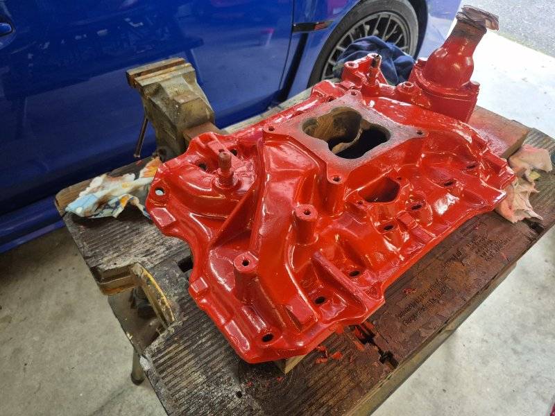

When my 354 Poly (318 with a 3.48" crank) went on the chassis dyno the dyno operator reckoned the factory 4 barrel cast iron intake manifold was holding it back. After consulting with poly guru Gary Pavlovich, I was advised to open up the 4 hole plenum to a divided opening, and port the runners while I was there. I wanted to pull the intake anyway as it had the felpro steel shim gaskets which are not great for sealing and I suspected oil was being pulled through the gasket on at least 1 cylinder. I ordered some fiber gaskets from Best Gaskets and used them instead (from Ebay seller CARS LLC Antique Auto Parts).
The opening up of the plenum was the hardest part - dremel, angle grinder, hacksaw (mostly) and carbide burr to finish off. Porting the runners was relatively straightforward, I worked out a slower drill speed works much better that fast - this was all done with a carbide burrs on my cordless drill. This is the first time I've done this so I was being very careful.
