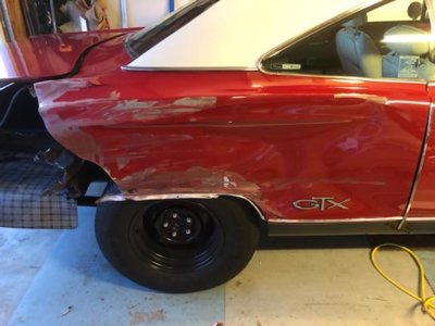

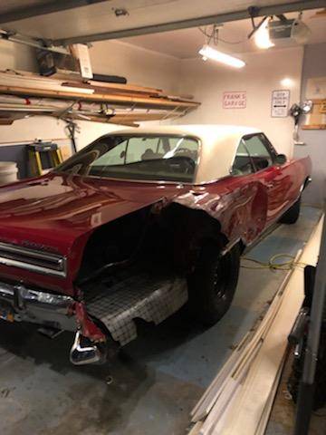

I just got word today that a Jeep wrecked my old GTX. It doesn’t look to bad. It’s numbers matching automatic with air, power windows, cruise control, rear window defogger and am/8-track radio.

new quarter, inner wheelwell & supports, maybe be able to fix the door,
bumper, taillights, trim, trunk hinge & latch maybe, frame or springs, shocks
& various mounts & repaint
(what I see possibly, quickly in that photo)
Then hope it matches or have to repaint the whole car

Sucks it happened but by the looks of it everything is easily found for that repair... Way better than seeing the frame mangled..

both rails are likely shoved over to the driver side, and the other quarter may be buckled a bit

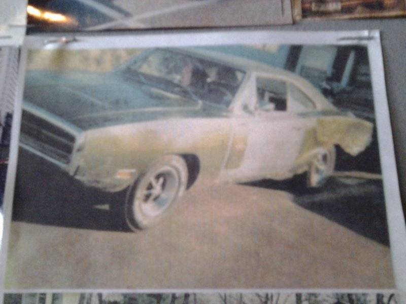

My mom's 70 Charger R / T SE, took this hit in 71 and nothing else but the quarter and the door got tweaked
My mom's 70 Charger R / T SE, took this hit in 71 and nothing else but the quarter and the door got tweaked View attachment 925528
the shot on the bumper and the gap between the deck lid and the dutchman tell a different story...... the rear body panel is over a good bit and pulling on the deck lid
Make before anymore is cut off that quarter. Make sure Its pulled and existing sheet metal is lined up first. Then your fitting of your new inner and outer will sit better.
The trunklid is probably bent,and sprung the hinge. The lid is the whole back of the car on those. There is not much of a tailpanel on those cars.
