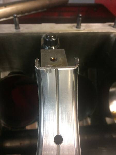

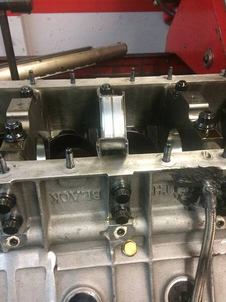

The thrust bearing is always a worry in manual cars and auto's too.
The pre 69/70 cranks/blocks are obviously designed for the narrower bearing.
Thats why if I'm building a 4 speed engine I like to use the 70-up 'wide flanged' steel cranks.
I have also modified the wide centre bearing to fit in the earlier block as well.
But where ever possible I would use the later CAST crank 440-blocks with the wider faced bearing.
We are very lucky here in the UK due to the large amount of EX-Jensen 440 engines.
They are all 1972-1976 HP blocks with the wide bearing SP crankshafts!
Thay all have SP rods and a quick change to a Hyper piston and the 'jobs a gooden'...
