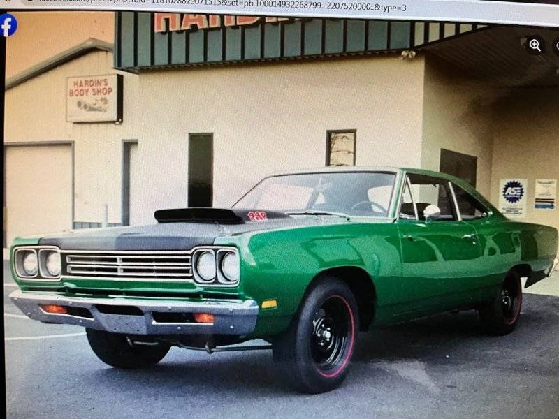

Dilemma: I have a 33,000 mile numbers matching A12 RR with recent cam lobe issues. I'm considering using this opportunity to pull/rebuild the motor, and want it run a little stronger and make a respectable showing on the street (on the rare occasion that it's needed); but not to the extent that would hurt the value or risk damaging the matching block/etc. I've considered building another engine, but really want the car to remain "the real deal". Could anyone suggest a formula/blueprint or builder that could help me achieve these goals?

Awesome A12!! Love the color... I wouldn't think twice... The numbers block would be on a stand & a 512 would be living under that big ol' scoop... It'll still be the real deal... On Steroids..
Your car looks to be a serious collectors item. I understand the need to play. I agree with @1 Wild R/T keep the engine with the car and build a play engine. Everything else can be fixed except that matching numbers block.
She’s a stunner. Love that color - remember it well on the a12’s. That is a true classic, iconic collector package all the way around. Don’t screw w/a 33k original heartbeat. As the others have said - if you just have to play don’t mess w/that engine to do so. Not sure why that 440 6 isn’t play worthy as it sits. Mine 68 X sure as hell was and the six pack was an add on. Not a true A12 but didn’t need to be. No one ever crawled up my tail pipes. More or less they were all in the rear view mirror…..

Great car!
accomplish these goals? View attachment 1680966
