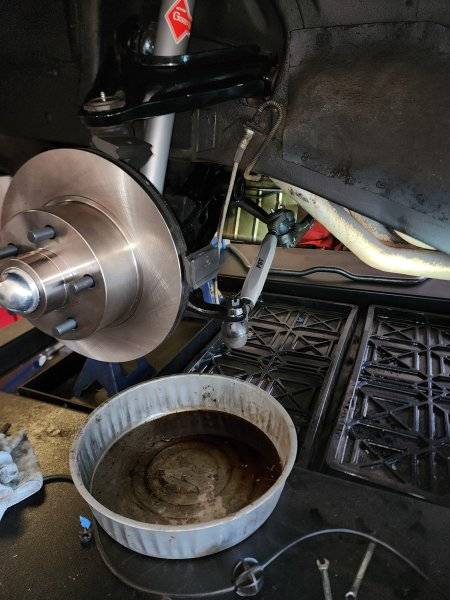

Recently rebuilt the front suspension on my 67 Coronet. My front sway bar was missing, added one from Hellwig. I have always used the poly super front end rebuild Kit from PST. This time I added the larger tie rod ends, and steel solid adjuster sleeves. A front end rebuild always improves driveabilty, The tie rod upgrade improved steering response.
Nice! I have a Hotchkis sway bar that came with the car, but I have to either weld on sway bar tabs to the lower control arms or get new ones with tabs installed. Did you do anything with your torsion bars? I see a lot of adjustable ones on the market now.
My car had a sway bar from the factory, but since it was a drag car before it was removed. My lower control arms had the sway bar tabs. The Hellwig kit comes with brackets that bolt on (on the lower shock bolt)if you dont have the tabs. I did not need them, I can send them to you if you want.
My car had replacement (.98) torsion bars on it when I got it. They were in gerat shape with the part# Tags still on them so I reused them. If your asking about adjustable upper control arms, I don't think they are needed unless you plan to autocross.
