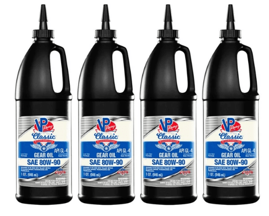

I just put this in my 4 speed.
I got mine from Amazon but Walmart sells it.

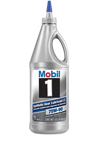

I use
Mobil 1™ Syn Gear Lube LS 75W-90​
Supreme performance synthetic multi-purpose gear lubricant​
No rating value Average rating value is 0.0 of 5. Read 0 Reviews Same page link.
(0)
Write a review
Mobil 1™ Syn Gear Lube LS is a supreme performance, synthetic, multi-purpose, SAE 75W-90 automotive gear lubricant designed to help meet the highest level performance requirements of modern passenger vehicles in all types of operating conditions including limited slip applications, as well as, deliver outstanding power transfer performance.
Compared to conventional hypoid gear lubricants, Mobil 1 Syn Gear Lube LS 75W-90 performs exceptionally over a wide range of temperatures. Mobil 1 Syn Gear Lube LS 75W-90 achieves this through a unique proprietary formulation, that deliver optimized viscosity-temperature properties together with the highest level of inherent formulation stability and helps to protect against thermal and oxidative degradation, wear and corrosion, viscosity loss associated with premature shearing. It also can be used in extended service and for aiding in fuel economy performance.
Buy Now
Ask technical
Applications​
• Mobil 1 Syn Gear Lube LS 75W-90 is suitable for use in modern high performance automobiles like SUV's, Vans and Light duty trucks requiring API GL-5 level performance
• Mobil 1 Syn gear Lube LS 75W-90 is intended for initial fill, topping-off or refilling differentials, final drives, transfer cases and other gear applications where lubricants meeting API Service
Properties and Specifications​
Property
GradeSAE 75W-90
Density, g/ml, ASTM D12980.859
Flash Point, Cleveland Open Cup, °C, ASTM D92150
Kinematic Viscosity @ 100 C, mm2/s, ASTM D44514.6
Kinematic Viscosity @ 40 C, mm2/s, ASTM D445103
Pour Point, °C, ASTM D97-39
Viscosity Index, ASTM D2270146
I've used this for 30 +years...NO DEGRADATION TO SYNCHRO SLEEVES, TEETH, SHIFTING FORKS OR SEALS. Smooth shifting......it does NOT deteriorate brass.....but use what you like.....just my opinion...
BOB RENTON
Manual transmissions require an oil with a API GL-4 rating.
The Mobil 1 SYN gear Lube LS 75W-90 has a API GL-5 rating which is good for hypoid gears, like the ones in differentials.
Do not use a GL-5 rated oil in manual transmissions.
