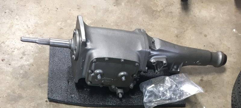

This is the one I have for sale May 1968 build date
I stand corrected, sorry yes the mount on the B/E style is farther forward, I guess I never knew that, the other option is, just swap tailstocks from yours onto a 68-69 style trans , they are same mainshaft I know that for sure, because I rebuild them all the time and there is only one slip yoke B body mainshaft. Sorry for the confusion
