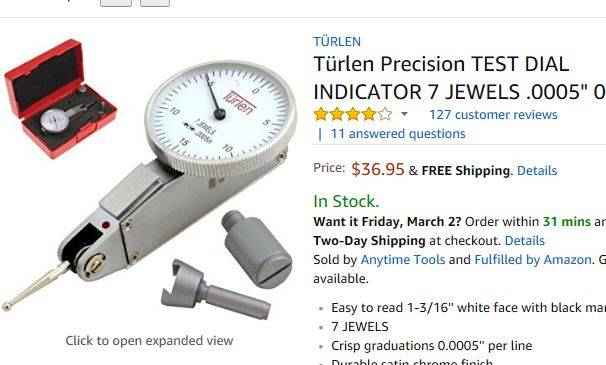

You can check it during install to me safe
