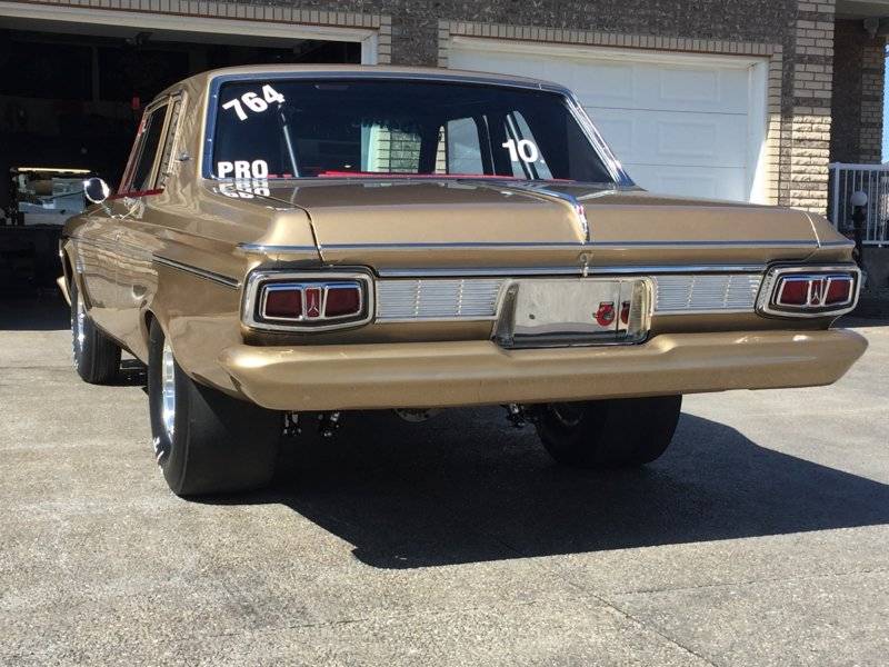

AAR Fibreglass Rear Bumper. Shedding Lbs.

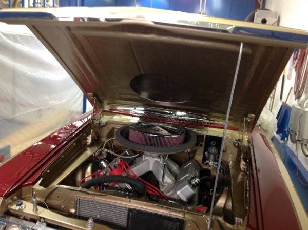

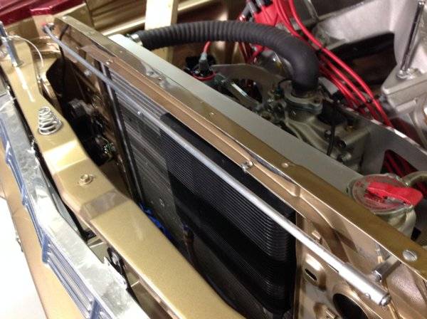

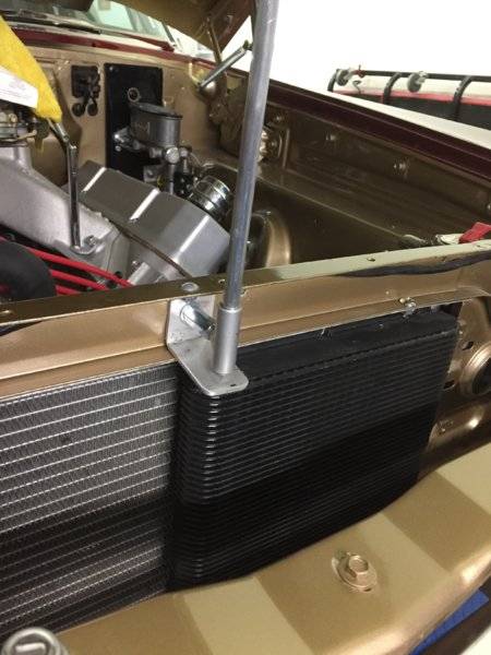

I tried the prop rod on the side and this hood did some weird ****. Lol.. So I moved to the middle. I'm going to try the side again now that the hood is finished and see what it does.
Hey LemonWedge. I tried the prop rod over on the side again. With the hood finished up it's rigid enough to stay straight and no longer droop. Changes made! Thanks for the comment on the rod!

GTX that is exactly what would happen..lol. What I had done was tap a 3/16 thread in the end and there's a large head screw in there acting as a stop.

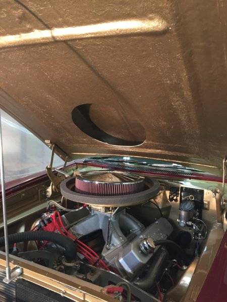

Update:
The fibreglass plenum in finished form.
Seals tight to the hood all the way around, will be able to report comparisons next season. Cowl verses hemi scoop.

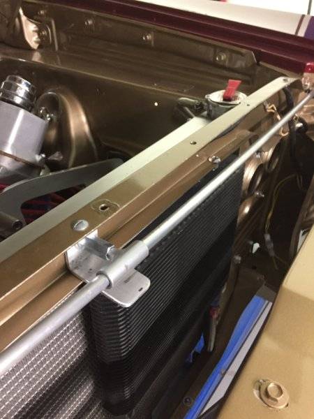

Not sure what guys do for prop rods but this is what I came up with.
3/8" aluminum rod, spins 90 degrees from vertical to horizontal position. I didn't want to use a hockey stick handle that seems to be common in these parts.

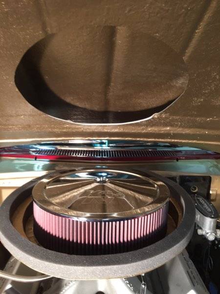

Malex...If you are going to run that air cleaner at the track I would suggest the air cleaner lid that is the "flow-thru" type, NOT the solid metal one. just sayin....
I see that K&N makes the flow-thru top for the 16" element so will be looking into that further. On calm days I'll run without a filter but on those brutal days filtered air is a must. Down the road there's going to be another hemi scoop with a quality fibreglass hood on this 64.

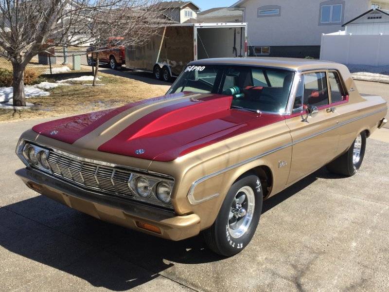

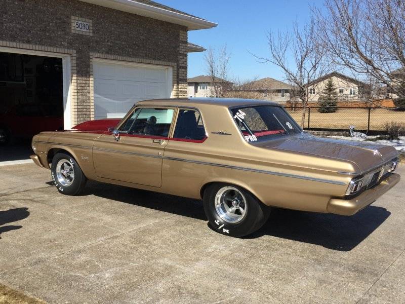

The 64 finally came out of the garage, first time since last September, 170 lbs lighter and sporting a new look. This year will be the Hood shoot out. 5" Cowl vs 5" Hemi. Will see what if any difference there is in ET and MPH.
Yeah yeah, it's a cowl hood, but, it's got a MOPAR stripe on it. It's straight!
Check it out.
Front end sits higher than it used to. Less weight and tall Front runners.
The painted glass bumpers give it a different look than the chrome.

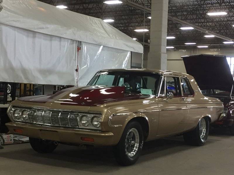

Have the 64 on display this weekend at a local car show. Driving the car the little that I did it sure has a different feel with the less weight, new converter and low gear set. Different in a good way.
I have to put a motor in mine before I can take it out of the garage. Monday!
