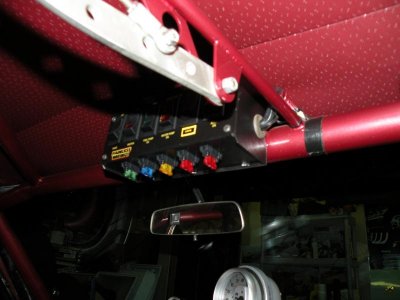

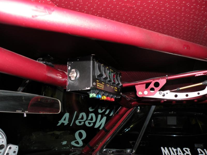

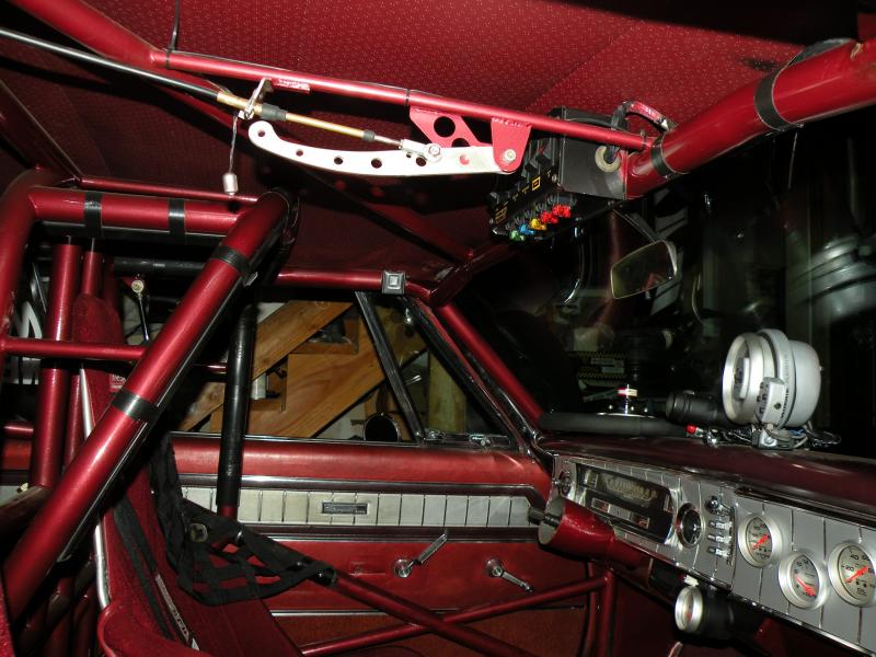

that's true. I would get a NAPA ST-85 solenoid to run your power through.heres a picture of mine.
my setup on rollbar

Thanks for the input Chis. Eventually ill be putting mine in the same place as yours. So go batt to solinoid to panel right?
YES mount the st85 under the dash by the loud pedal and you run your starter hot wire to left side on the stud and then theres also 2 unswitched or non hot smaller studs where your starter solenoid wire go to one of them, then you run your wires from your painless off of that st85.
Damn a lot cheaper on some types too lol oh well some of the 8 switch are more pricey. Another ? So the painless power will connect to the small non hot terminals like the starter solinoid? Or off the other hot that goes to the starter
depends on what you want hot all the time.
i keep my fan,water pump hot on big stud.
fuel pump and starter solenoid on small posts.
gauges is your call. i have mine on when i turn on my ignition.so small post.
lights should be on hot.
