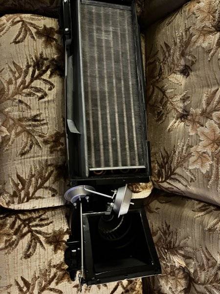

Hello. I am asking a question regarding testing the a/c heater box function for my 69 charger. I am in mid process with restoring the ac heater box. I want to bench test the full assembly when done with vacuum through the switch assembly at the dash for correct movement and adjustment before going into the car. What would anyone suggest for the best tool to use to draw vacuum? I have an ac vacuum pump. I considered a brake bleed had pump with the nipples to go into the end of the main line to the switch to move the doors on the box. Thoughts?

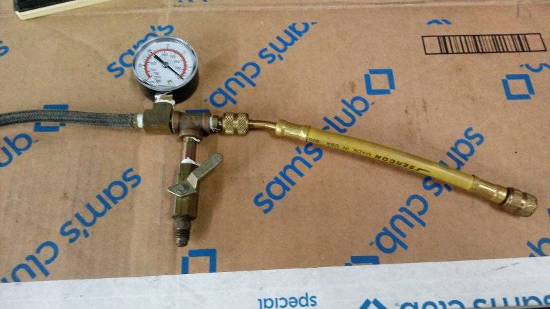

Little late here,but...I created this to check mine with an a/c pump ...FSM said test at 7 or 8 inches(don't rememember exactly atm)...valve is to bleed off excess vacuum as pump would pull 30 otherwise
Little late here,but...I created this to check mine with an a/c pump ...FSM said test at 7 or 8 inches(don't rememember exactly atm)...valve is to bleed off excess vacuum as pump would pull 30 otherwiseView attachment 1718346
Awesome thank you. I could easily make this. I have the pump just need the gage and valve. Good idea. Much appreciated. I have my box ready would be a good idea to just check it.
