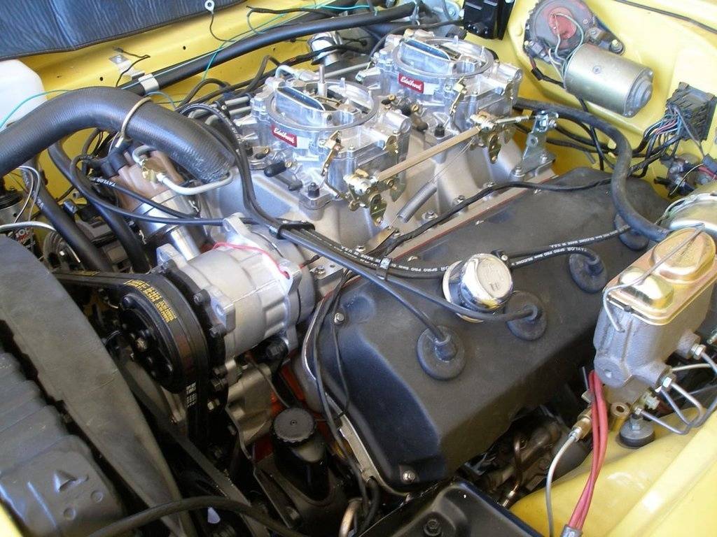

thanks super-bee_ski. i like the bracket but the compressor lines come out on the passenger side. my car is an original 6 and the heater lines come out on the driver side. they would have to be routed to the firewall and ran across to the drivers side. because of the the heater, they couldn't come through the firewall on that side. i will give them a call and see if their compressor can be rotated so the ports are on the drivers side.
Here is how I routed mine....
