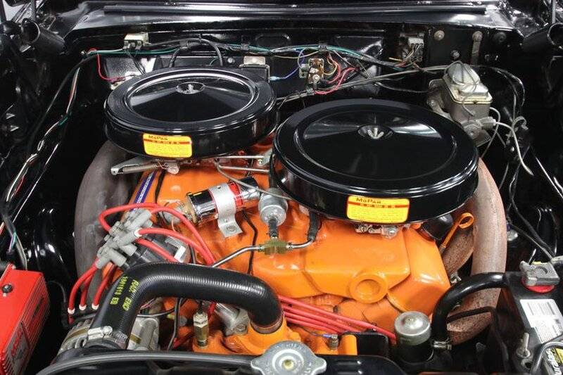

This is the current system. Metal line on left is from carter mech pump, brass tee fitting, then one line to each carb with their own filters. From brass tee are two short metal lines one straight one 90 with hose barbs. I have not looked but suspect the carter fuel pump is also a 1/4 npt flared connector.

Could you possibly replace the brass Tee, with a 4-way, and tap the FP gauge right up front ? May take some searching for it, but you may only need an adapter for gauge ?

1/4" sounds pretty small; are you sure your fuel lines to carbs are not 5 /16" ?
Automotive flare fittings don't use NPT. If your fuel lines are 5/16", which they look like, then you need 5/16 inverted flare to 3/8 male NPT adaptors, which are fairly common.
The lines at the tee are 5/16 inverted flare not npt. You could but another stock tee and drill it for 1/8 npt and install a gauge. I assume you want to keep it original so why not just get a piece of hose and some fittings for a test gauge and install it between the tee and filter. Once you are happy with the pressures just remove it and go back to stock.
