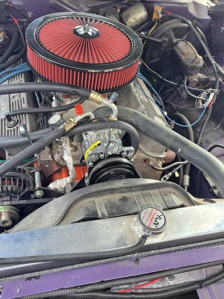

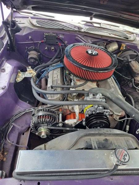

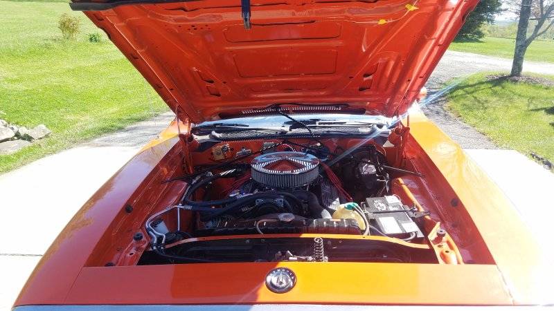

Hi, just doing some reading and see you would like pictures. I have a 440, but the most part you came lay out the hose any way that makes them look organized. Here’s my 73 Charger

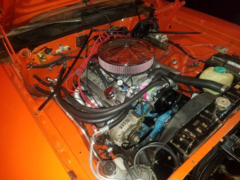

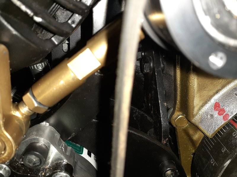

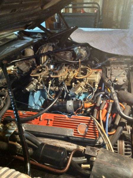

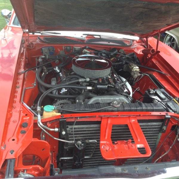

This is my own design for the system, but it might give you an idea on layout. Make sure you have enough clipping points if you are running hard lines- mine cracked at a brazed joint and I am going to have to repair it before the summer.
you would need an electric fuel pump for this way but neat install

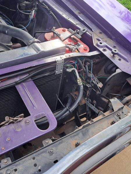

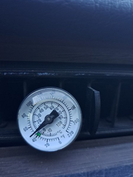

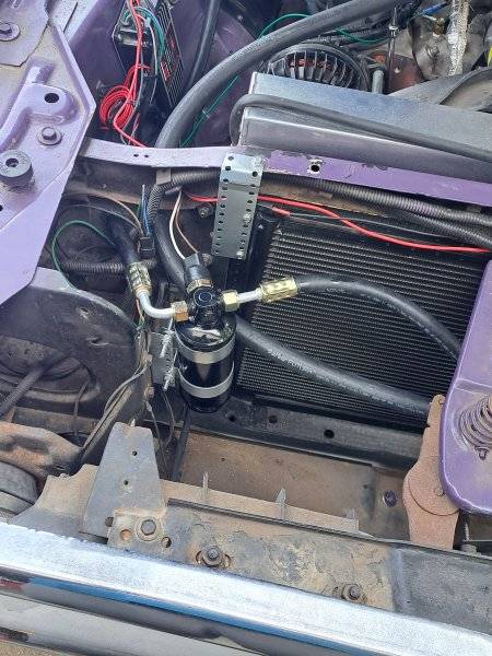

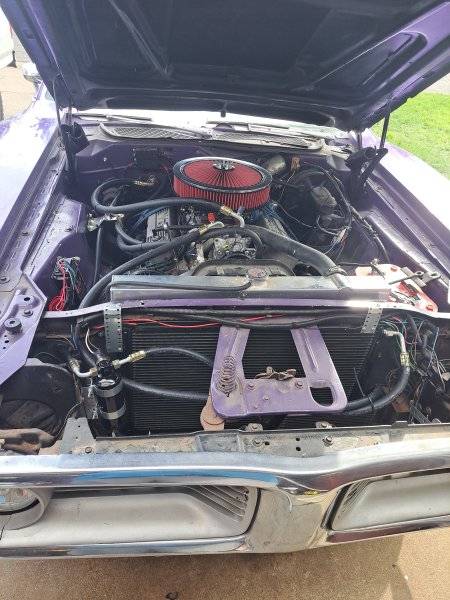

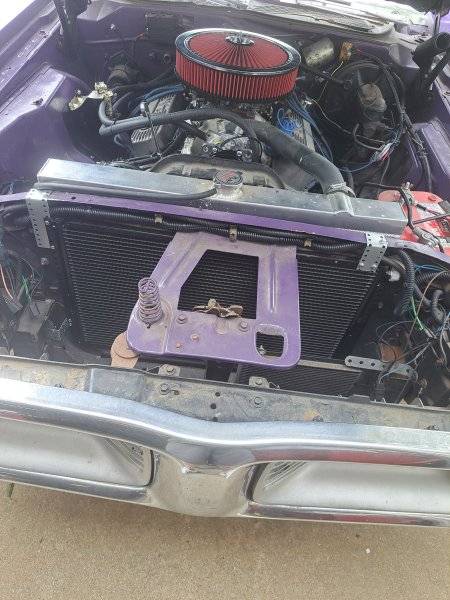

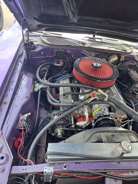

Install is done. Ac pulls down to almost 42°. It's awesome and I love it. Best thing I ever did.
