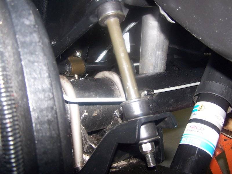

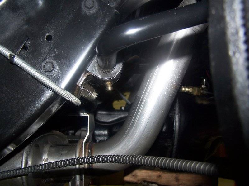

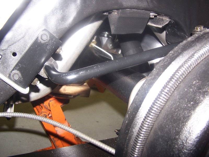

Front/rear bars on an a-body.
QA1 upper/lowers/strut rod in front.
Rebuilt steering column!
Handles like a dream.
Careful, as the car now remains level as you straighten the curves, if rear tires are too tall they may fold over and rub spring a tad.

Thanks for those pics. It does look nice and tucked up in there.
