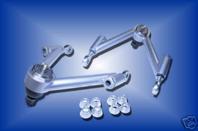

Also Mancini Racing SPC adj. on the car $240 each, like the ones below... I have some older but still new in the box & never installed, MP adjustable UCA's with poly bushings & grease-able upper ball joints installed, I will sell for $200+ shipping non negotiable price, my cost $399+ balck powdercoated & adjustable to 7*... I'm Going in a different direction, my loss your gain... QA1 also would be worth a look... PM me If you interested...

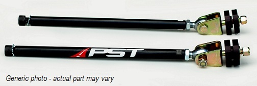

Ok, so it looks like I'm going to go with the SPC Adjustable UCA's
and a set of PST Adjustable Strut Rods

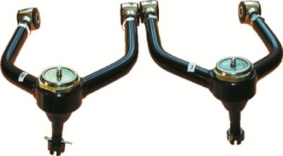

My alignment shop has recommended the Hotchkis.
Does anyone know how they compare to the SPC?
Thanks
Hotchkis Adj. Tubular UCA's
Thanks
They look nice, I have ever used any... they are also $856.95 for a set... about $270 more than the SPC's for a set... I think the SPC's are more adjustable & you can do the adjustments while they are mounted to the car, not have to remove any UCA bolts to adjust them, just take weight off the car & loosen the jam nuts, then do your adjustments...
There is also Magnum Force Racing Double Adjustable Tubular UCA's for $ 389.00, the silver colored one's below
