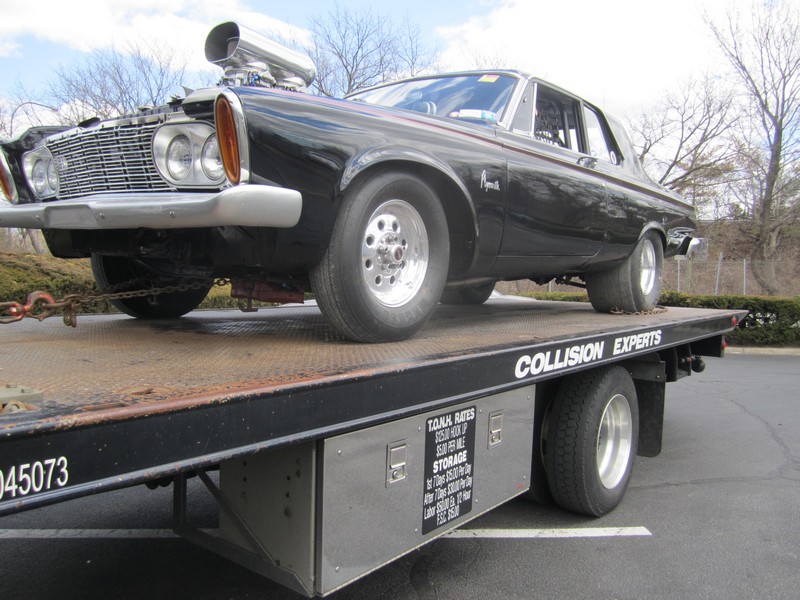

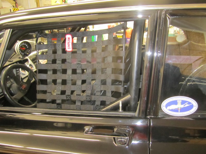

I've seen lotso pro streeters.I dig when they do something to set itself apart and stand out in the crowd:headbang:

Well yours just rocks. That's all there is too it.
Showoff.
LOL
