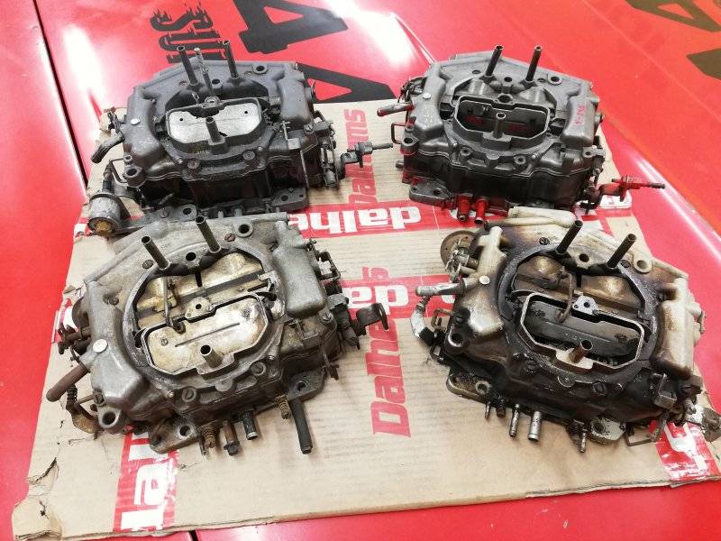

Hello, I have several core ThermoQuad carburetors that are good candidates for rebuilding but I have never actually tried going through them by myself.
I have rebuilt Holleys, mostly the 600 and 750 CFM versions. Holleys are easy for me but that may be because I started out with them way back in the 80s. My red Charger has a Demon 850 which is a Holley based unit.
I used to have a local guy rebuild carburetors for me but I want to do these myself from now on. I have a few cars here that would benefit from a well tuned Thermoquad since they can actually deliver decent mileage as well as make those glorious moaning sounds at WOT.
What tips or suggestions can you offer to help a man have success with these? What brand of rebuild kit is worth a try?

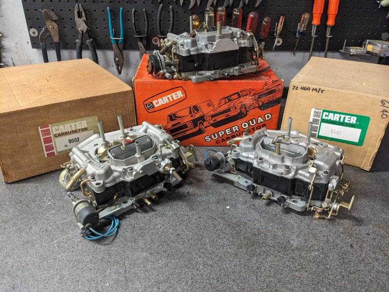

Adding some TQ eye candy too.
A bunch of 6324, one bought from a member on this forum. :thumbsup:
If you want quality OEM Carter kits for a TQ, or tuning kits (not cheap). Or friendly TQ advice…Contact the Carb king.

This is the carburetor that inspired the thread for me.
I don’t remember where I got it. I had a guy at a local shop go through it. He did say that I’d need to install and run it in a short time but I got distracted with other things and let it sit.
This one PUKES gas up the throat as the car is running. I figured the needle and seat were stuck so I tapped on the top with a ratchet but it kept pushing gas so I pulled it and swapped on a known good Holley 600.
It essentially has zero miles, it just needs to have this one issue addressed. These are the only numbers I can see at a glance.
With that ugly, bulbous thing at the front I suspect it is from the mid to late 70s.
The carb guy used to rebuild stuff for me in trade for parts he needed for his Dart. I lost some of my rebuilding skills by farming out the work instead of doing it myself.
