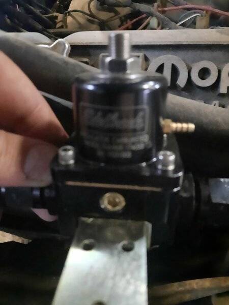

I run my line from electric fuel pump to dual feed for carb, then out back of carb dual feed line to regulator then from regulator back to fuel tank. Set regulator at 5-6 psi.
Its all from summit.
Fuel tank from Tanks
255 walbro
Edelbrock adjustable regulator
Braided 1/2" line w 8an ends return and pressure...

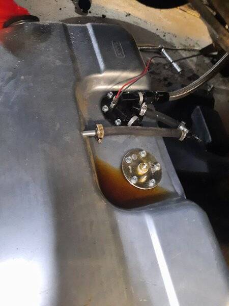

I happen to have pictures. We looked at piecing it together and decided to do this for a couple hundred more..fuel injection maybe some day... feeding a holley 850race dp
View attachment 1084280 View attachment 1084281

Looks like the kit on summit comes with the 255 walbro, which is what I would need. But I do see on tanks inc. website you can choose. I noticed on the kit, the mounting plate is a brass plate with brass NPT fittings, unlike your black one... maybe they changed it?
Also, you said you're running 8 AN ends with a 1/2" line. The kit says the mounting plate has a 1/4" NPT for supply and return lines. Is that the same as yours, but you attached 8 AN ends to the 1/4" NPT's so you can run your 1/2" braided line?
There is a fitting we used to adapt it from 1/4 to 8an. 8an was actually a little big, we ground the corners off the nut so we could tighten it. 6an is meant to go right on. Doing it again I would guess there is a better fitting to use to go 1/4 to a 6an w 1/2" line?..... But I haven't looked, it was simple enough to modify. We buzzed the corners off the fitting with a grinder so the 8an nut could turn.
