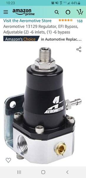

what fuel pressure regulator did you use on your Aero Gen 2 stealth tank?
I used this one. But this is for fuel injection. It can be dialed down for carburetor as I used one on my blowthru turbo jet boat also. For the car, I ran about 1 foot of fuel line from tank to regulator "in", 1 foot from regulator "return" back to tank and then regulator "out" to factory 3/8" hard-line. Jumper wire fuel pump on and set pressure at whatever pressure your carb/floats like. On the boat, tank to fuel log on double pumper, line from other end of fuel log to regulator "in", line from regulator "return" to tank. Set pressure at 7psi for my carb and hooked up reference vacuum line to port. As boost goes up, so does fuel pressure at 1:1 psi. For the blowthru turbo setup, I prefer to regulate after the carb. For efi, before to simplify plumbing. If it were just a carburetor, I'd go before also so simplify the fuel lines.
