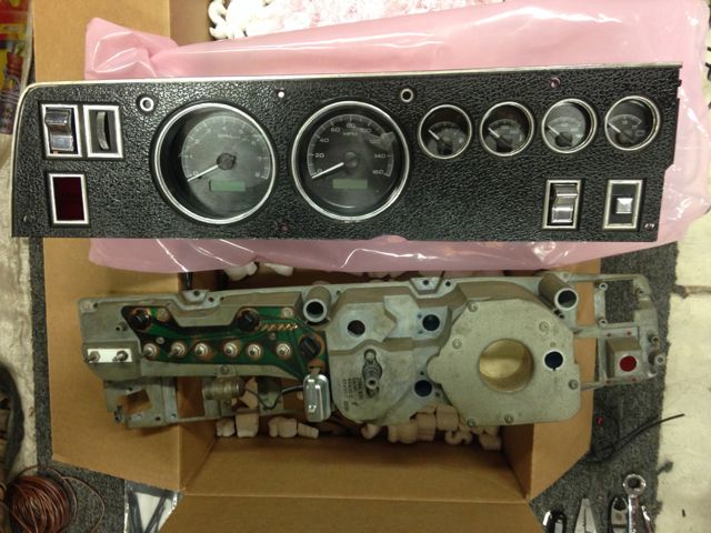

Shiny silver box in the middle of the photo is the voltage regulator. If the gauge console in mounted in the car, the VR is just to the right (toward passenger side) of the speedometer cable.

The problem is getting to it. If you have big hands pull the cluster loose from the dash far enough to reach behind. Will have to disconnect speedo cable and battery. Then pull the old one out and push the new in. Make sure not to dislocate the capacitor wire while replacing the limiter or you will have radio noise.
