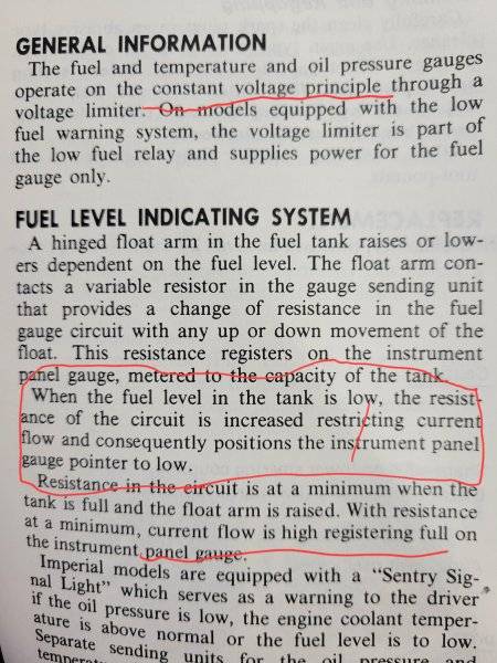

Ok, here's a question. Are the gauges powered ?But you can't use an ohm meter with voltage present..... well you can, once!
With a variable 5 volts. It's variable as the ground side has a resistor that changes value via the sender. Gauge is basically reading either full 5 volts at just over "full" (why 10 ohms is actually full) or the resistor reduced voltage amount at "empty", or anywhere else on the scale.Ok, here's a question. Are the gauges powered ?
I know. I know the answer which one of you is correct. Yes, the gauge is powered. Is it indicating volts, or ohms ?With a variable 5 volts. It's variable as the ground side has a resistor that changes value via the sender. Gauge is basically reading either full 5 volts at just over "full" (why 10 ohms is actually full) or the resistor reduced voltage amount at "empty", or anywhere else on the scale.
Not it you just sweep the gauge. Thats how I checked mine to see if they were any good. 3 aa batteries are 6 volt, 5 volts is what the gauges get constant.That's what I'm getting at.. by trying to measure the voltage of 3 batteries, you won't get a reading. You'll get a burnt gauge.
THANK YOU ......for the "recognition"......I won't do a "Renton" on you and leave my pinky ring in the jewelry box, but it's just a volt meter being manipulated by a rheostat.
Ok! I'm trying to get on board. So what would the gauge go to if it had zero ohms.With a variable 5 volts. It's variable as the ground side has a resistor that changes value via the sender. Gauge is basically reading either full 5 volts at just over "full" (why 10 ohms is actually full) or the resistor reduced voltage amount at "empty", or anywhere else on the scale.
Just slightly beyond the fringe. You'd have had to grow up in the Ottawa Valley to get that one, dealership in Stittsville! Seriously, it would just go slightly past full and possibly damage the gauge.Ok! I'm trying to get on board. So what would the gauge go to if it had zero ohms.
That was the point I was making about using it as a voltmeter. I guess. But I'm never afraid to be proven wrong. And my knowledge of how analog voltmeters work is pretty limitedJust slightly beyond the fringe. You'd have had to grow up in the Ottawa Valley to get that one, dealership in Stittsville! Seriously, it would just go slightly past full and possibly damage the gauge.

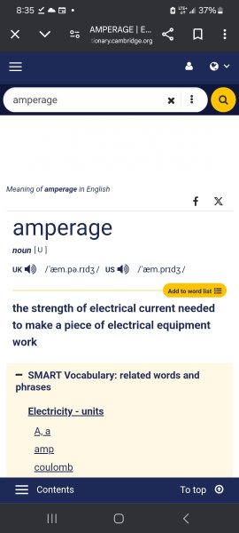

the word 'current' is more appropriate here, but that's just my opinion of course.but you're still just increasing amperage
..no?
the word 'current' is more appropriate here, but that's just my opinion of course.![]()
