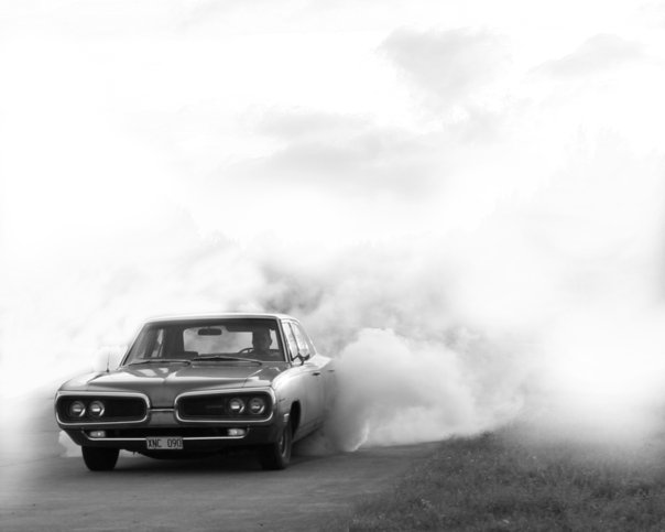

You are my new hero doing that in a daily driver 4 door Kalle. I can't help you with the technicals and will leave that to these heavy hitters but look forward to how this goes.
Mind showing some pics of the steed this thing is gonna go in for us in the peanut gallery?

The car is now all tearen down for some bodywork, but i drove it one summer after swaping the org slant6 to a 440... So this is what i started with:
