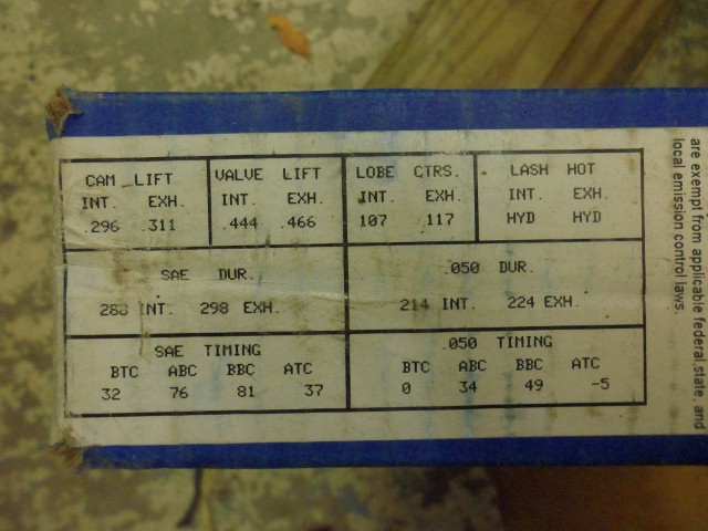

Hi guys,
I'm rebuilding my 440 fairly stock with maybe some port work but nothing crazy. Running HP manifolds and dual quad intake. Just wondering if this cam will work. It came with the car. I'm looking for a little lope in the idle but I don't want to sacrifice performance.

That cam will not give a lope when the engine is all warmed up, thenterline needs to be numericaly low. That one has a 112 centerline. (half way inbetween the 107 & 117 numbers) Also, when valves open and close quick, it can add to the note that comes out. The advertised duration numbers vs the ones @ .050 show this cam to have slow opening valves. This looks like a Crane cam or a Wolverine.
You can find a similar one from Comp Cams with a 110 centerline or you can ask them to knock it down 2 degrees to a 108. That'll chop at idle real nice.
Do you know what your static compresstion ratio is? I'm no cam guru but that looks to me like it's going to give your engine a lot of cylinder pressure and if your compression is already up, that's just going to put it over the top and you'll have ping issues. Now if your compression is low, then that cam will help it think it has more....but like 360 said, fairly smooth idle.
Not much lift either. Probably close to stock, with more duration. Just my .02
Ok, I thought it was kind of mild, just figured since I already had it....
When the time comes I'll just get one that the engine builder recommends. Thanks guys.
Another thing you can pay attention to is when the intake opens. Advertised rates are just that and advertised numbers are usually listed for anything before .050 lift. Not much is happening before .050 lift and the numbers that are listed @ .050 is what should catch your eye....and any cam that lists an intake valve opening that's '0' @ .050 and closes more than 30* ABC is usually going to have a very high vacuum and pack the cylinder full. Not a real good cam for higher compression engines but works well in low compression engines....

I'd use the cam.

I think Rumble pegged it as Wolverine. I ran one in my 68 302 Mustang and it ran OK. Funny how the specs are the same except for lift. The idle had a faint rumble to it if you listened really hard. There might be better cams for your application (like the factory magnum cam), but since you have this one it shouldn't hurt you. As mentioned verify the compression requirements, however, I don't think you will have any issues with 9.0:1 as long as you shoot for about 160 PSI of cylinder pressure for regular 87 gas. Missing the match between compression and cam will hurt you!
The advertised intake closing point is the most important for determining cyl pressure because you can't build any pressure when the valve is off it's seat. Compression is your friend if you run the proper gas to support it. From the sound of things you may not notice much difference compared to the cam you have now, if the one you are running is mild.
