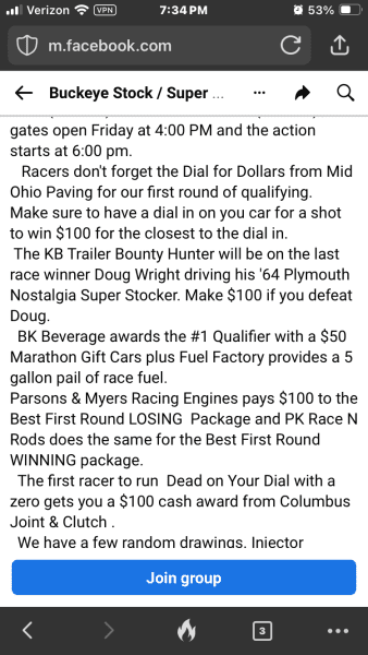

Better be quick Doug, there’s a price on your head.
Had a $100 bounty on me last weekend as well. Came up one round short of keeping it.
