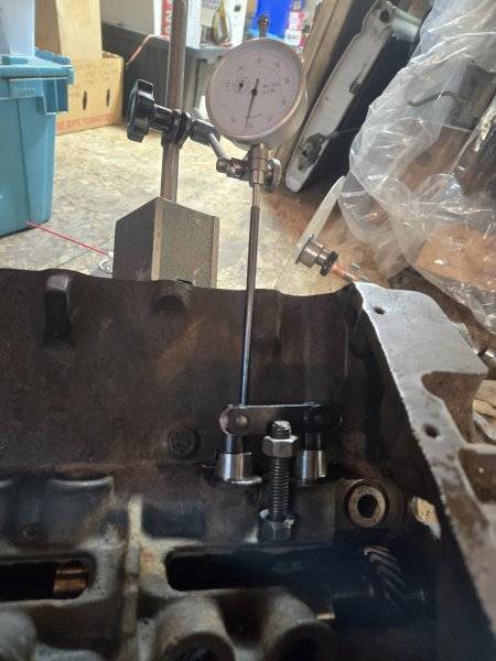

There is a large magnet (4' diameter) taped to the outside of the rear of the aluminum pan under the daiper. It does a great job of retaining magnetic particles. The oil was changed right before all of this started. The filter was cut open, looked great. The cam is out. In my notes from the build prior to the 2022 season it states there were some pits in the intake #5 lobe. Obviously they're worse. I'm not sure the replacement cam hasn't been reground. It's hard to get a straight shot with the dial indicator on a lifter with the heads installed. Going to put it in a spare 440 block, attach the degree wheel to the cam itself, drop a lifter in and measure it. Obviously the numbers will have to be divided by two reading directly off the cam. At least one lifter wheel is damaged. A friend has some spares. I will check the other lifters in our fixture. If everything looks ok? I'll install this cam with the borrowed lifter pair in #1. Send this lifter for repair. The #1 lifter pair can be snuk ou through the distributor hole. I tried and was able to do that already. Kevin from I J crank scrapers has been very helpfull. he has a solution for the windage screen. Even sent me parts yesterday free. That's great service. I talked to many about the intake gasket issue. Going to try Ultra Grey. A fellow Indy head user said he tried everything. And that's what solved it for him. I do use it to seal the upper and lower intake halves with no gasket. We may make next weeks race.

I had a Comp billet roller a friend got used. Didn't know if it had been reground. It had the Comp numbers on it. Very close to what was in the engine. Same lobe family. .24 greater intake lift, 4 degrees more exh duration, 111 LCA instead of 112. Today was spent cleaning a old 440 block good enough so it would take the cam and a pair of lifters. Then modified a degree wheel to bolt to the cam. Got the dial indicator out and did all the math. Since there was no TDC w/o a crank I started at the intake C/L and worked my way from there. It is what it says. New lifter pair ordered from Isky yesterday. Windage screen ordered Sunday. Looked back on the 2022 build. Coil bind will be close. I checked each spring for coil bind then. For some reason all the springs with the greatest coil bind distance are on the intakes. So I'll shuflle them to the exhaust. Everything is cleaned up and ready to assemble starting tomorrow.

Today had to swapp springs around so it had enough coil bind clearance for the increased intake lift. The Pac 1224 springs will take .850". However I run them at 1.950" instead of the recommended 2.00". So each spring was removed and individually checked. Even though Pac lists bind at 1.100" 8 were less than 1.070" The springs with the greatest coil bind clearance went on the intakes since the new cam has .024: greater intake lift. Its close but itll all work. Can't work on it tomorrow. But everything is ready to put back together on Friday.

Cam is installed. Still waiting on the lifter pair. .837/.810 with checking springs and no lash. 285/296 on 111.5 lca. Had to measure every spring for coil bind. Put the ones with the most clearance on the intakes. It has .050" with lash. P to V .075" int, .110" exh without lash. Checked all the spring pressure on the engine today. All 285-290lbs on the seat except #8 exh. I have spares so I'll swap it. So far, so good.

Got the lifter this afternoon. Had everything already reassembled. Just had to slip the lifter pair through the distributor hole. A little finagaling with a magnet and it was set. Lashed it, primed it to make sure it oiled up through the pushrods. installed the pump drive and distributor. Fired right up. Tommorow it'll get a timing check and trans fluid topped off. Then it's into the trailer for Wednesday test and tune at Milan dragway.
