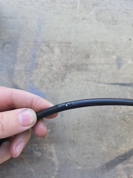

What is up with these spark plugs? This is even bank, 8, 6, 4, 2. I pulled 7 and it looks like other 3. There could have been manifold vacuum leak but wouldn't that make the plug lean? The wire to the distributor could have been loose. What else should I be checking? Again this is a junk yard engine, so a compression test?
These are Autolite 3923. It has Edlebrock heads.
I did pull each plug wire when the engine was running. For me, it was inconclusive.
The float level is 7/16 without the gasket, so a little high.
The even bank valve train looks good. The push rods spin, the throw looks all about the same, the looseness of the rods seems about the same.
My plan is to pull the remaining 3 plugs. Clean plug 4 and swap with another. Lower the floats. Reassemble. Focus on #4 plug wire, maybe swap with a left over wire.
I found the #4 plug wire was damaged on the header. Swapped in a replacement. Replaced the plugs. It's idling the best it ever has, kind of fussy to tune. Seems to like a rich idle mixture. Also advanced the ignition time some more. Still stumbles, but I feel like that is more of a cam thing. Tomorrow I will blow out the cobwebs and see how it does.
