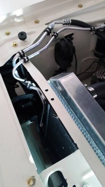

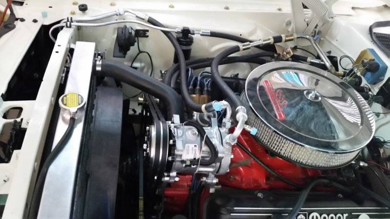

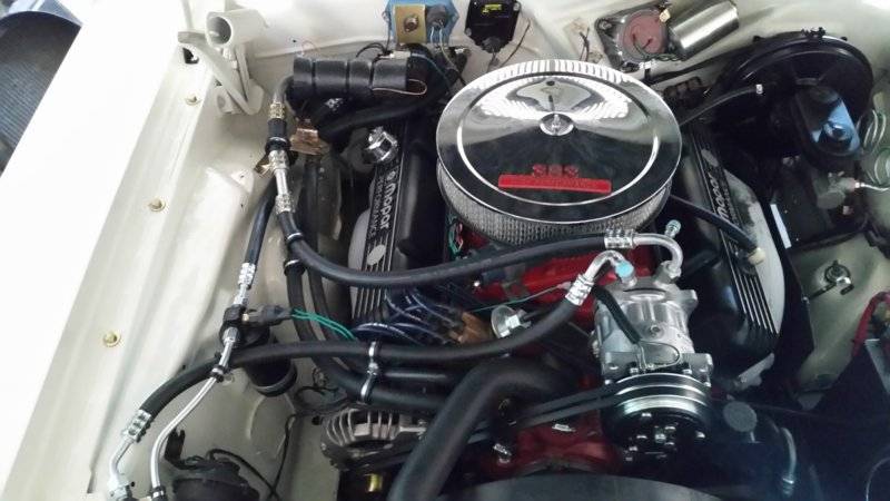

Hi, is your car an ac car? That would make it easier but any car can be made to have ac, just takes doing a little homework and the ingredients to put it together. The enter net is full of people that have installed AC to their cars. If you want something bad enough wrap your hands around this project and make it happen.
Good luck,
Azmoparboy
This is my challenger, and it has a 383 in it. I built this ssystem up myself, just did my homework
