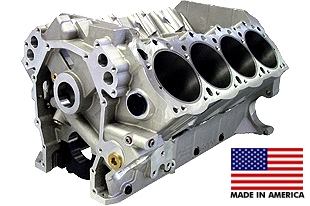

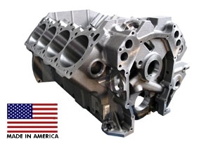

I haven't used any yet, but there are also World Products BMP 440W & 426H Aluminum Blocks are also available, I think in 4.310" bore upto I think 4.530" bore & upto 4.75" strokes... There are a few used JP1 {Joe Pisano} & KB {Keith Black} Aluminum Blocks available too, I haven't used any for quite a while now, Milidon made some too...
