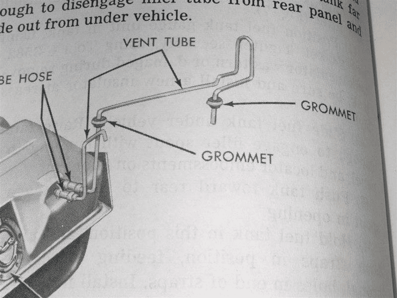

These are what was leaking. The one on the right the most. I'm confused. Why would this leak so badly? Unless I am reading this wrong? The arrow on the bottom left is pointing to the fuel pump, not the gas cap, right?
Useful.
Mine don't route into the trunk. I'm not even positive where they actually end at. Very hard to get around in there with the car on the floor. I think they just cut it off when they did the trunk pan and left it. But they leak.
Fuel pump is on the engine, not in the tank!
Every other car I've worked on had a fuel pump in the tank. Stood to reason the disc cap with two lines running out of it was an in tank fuel pump because that's what they all look like.

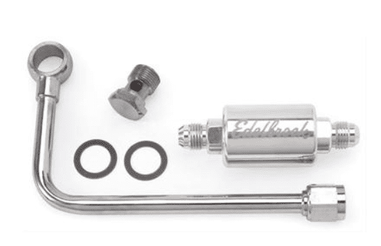

Another bummer of a day. Discovered all of the nice Edelbrock stuff (8131 pictured and 8123 stainless line) I bought to connect my new AVS2 to the vapor separator won't work because the M1 dual plane intake manifold blocks the fuel filter. No working around that. So I'm back to square one and $100 poorer for trying and still have to figure out how to run these lines and what to buy. I have all the stock metal lines but they won't help unless there's a slick way to connect that small gap between the line and the carb (pictured). I suppose a small length of rubber might suffice but feels cheap. Kind of wish I had just repaired that Holley but it was giving me so many headaches with leakage and then the dumb base ears cracked off so I was over it.

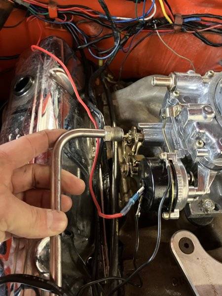

I have decided to attempt bending the Edelbrock stuff above and hope it doesn't mar the finish. My friend has the correct tool to bend metal line and also a flaring tool. If it fails I will attempt to separate that line from that eyelet and create a custom hard line using that, or just find a 5/9-20 inlet from a Carter AVS and flare that on. For now the rubber will suffice.

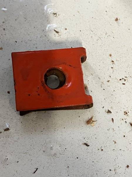

Hood was not seated correctly and the paint has rubbed off down to primer where the drivers side of the nose meets the grille black plastic. I always thought it was off because the hood pins were never centered. Worked with it for a while and it still is not right. Then noticed the driver side grill has aftermarket hardware and I am under the impression something is not lined up correctly but cannot figure out how to remedy this. These bolts are backed off so far that hardware is merely pinching the plastic in place now, not seated in the middle of the original holes. Something deeper has to be bent. I was able to adjust the hood enough to make it better, but not perfect. It's one of those things I can stare at for half an hour and still fail to figure out. Should I take a razor and shave the plastic? Probably going to ignore it for a while.
