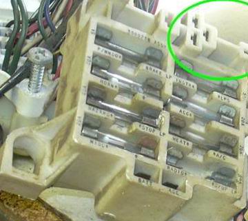

I'm not sure if 70 had the newer style fuse block or the old with no external connections. 70 service manual shows the newer.
If it is the newer like on my 73, there will be outlets at the bottom for accessories.
One should be constant and one keyed.
Ignore the circle in the pic. I am referring to the two at the bottom, one is labeled "Batt" and the other I forget at the moment. Batt is constant.00FuseBox02.jpg
I would go the Y plug route if it were me. I hate messing with the back of the fuse box.
See that plug hanging down in the pic? If its a red wire it should be a keyed.
There is a spot. I like doing things neatly. Get another connector and make a Y type plug. Be sure to use a fuse to the tach.
