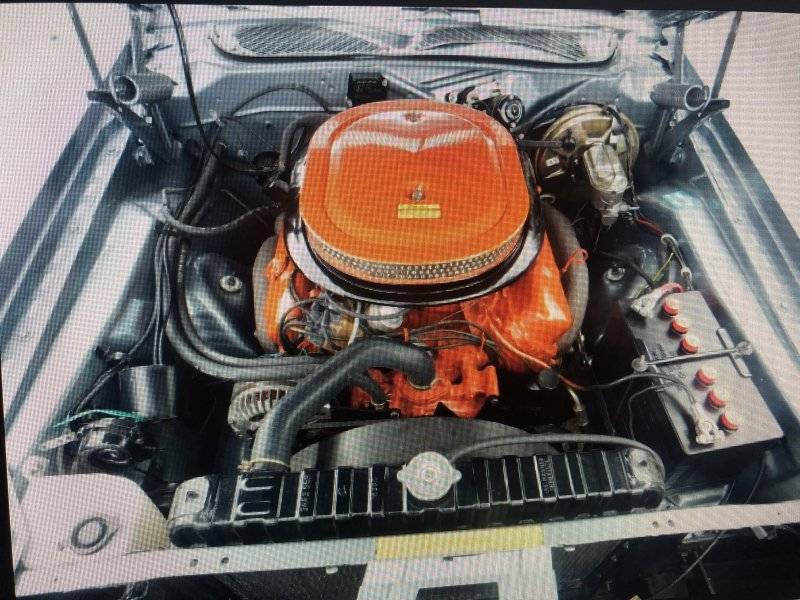

Anyone with a 71 Charger equipped with air grabber confirm location of the vacuum canister please? I believe it is on the firewall by the hoses similar to the 70 GTX. Pictures would be great. Thanks.
In 1971 it is on the passenger inner fender near washer bottle unlike a 1970 which is on firewall.
Perfect - thank you for the clarification.

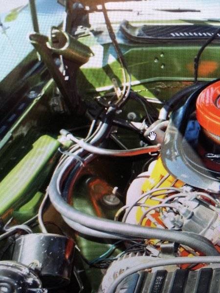

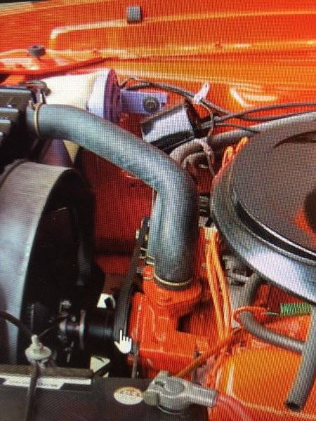

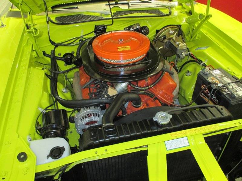

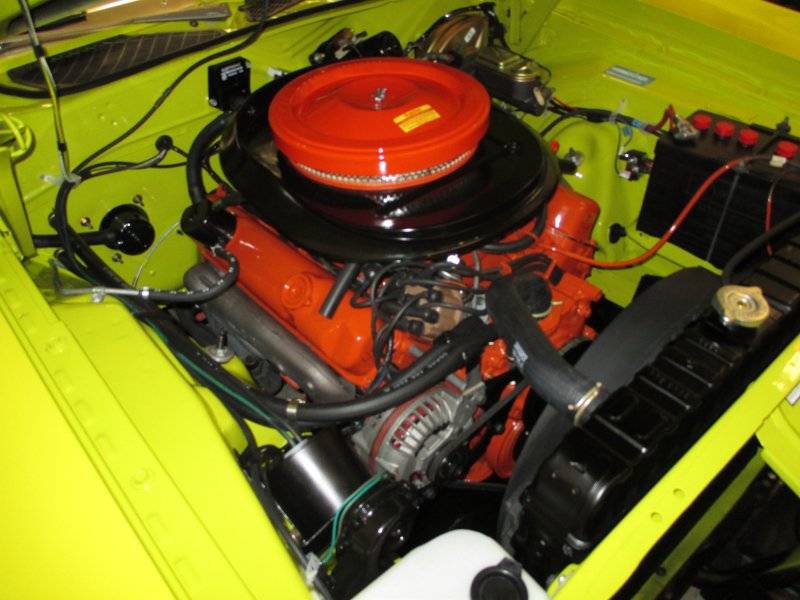

Here are a few more samples. The inner fender might have two holes already or at least two dimples on an angle that can be drilled out.
Thank you for the additional photos. I did not notice the angle before.
