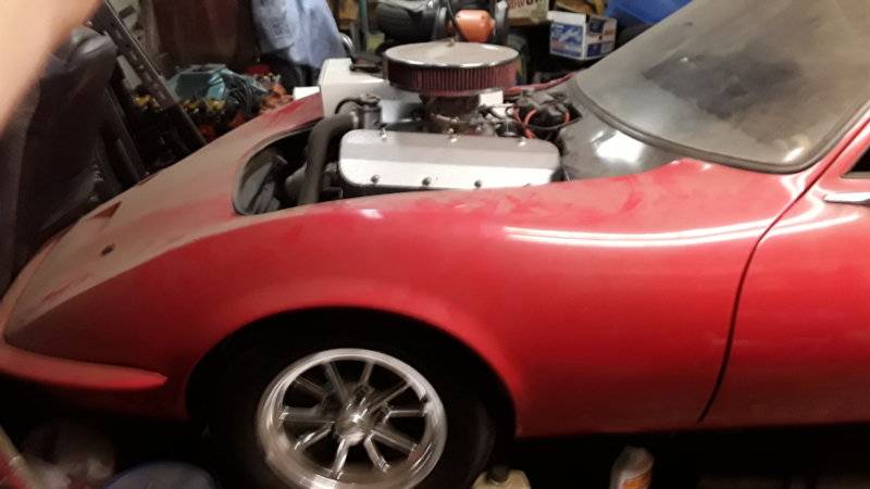

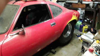

Those gah dawful flames are going to be GONE, before it gets out of the garage again.

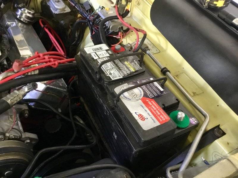

AAA here. AGM won’t fit. Too wide and high. Didn’t have time to shop. Fucked up back, can’t do the job myself. Thanks for advice. Modern cars will get AGM’s. Going down the Coast Monday to meet up with ckessel. Linda twisting my arm to take a modern car. No way.
Jesus Christ! How'd you get that BBC in there????? What kind of brakes ????
He had an AGM on the truck that fit but it was smaller and did not fit exactly in the tray.
That is a YUGE battery! I bet it could start the space shuttle if needed, lol!
@zyzzyzx, it's an old tube chassis A/MP car, straight front axle, fourlink, very narrrow 9", firewall moved back a foot and a half, aluminum dash. Ran mid-high 8 quarters, now a street strip car with a giant radiator from a dually pickup, set at an angle (no kidding.) Gonna replace the current 454 with a blueprint 540, wanted a 632, but a tall deck wont fit without a new custom set of headers.
Edit : i forgot. Jfz discs all around.
