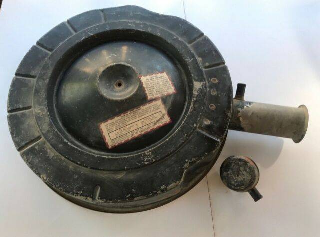

The original air cleaner ( that I really like) can't fit now as the throat plate is about 4-3/4" in dia and the Edelbrock is 5-1/4" dia. The original air cleaner was always very close to the hood insulator, so an adapter would not have room.
Does anyone know of a throat plate that would work with the original top?
What has worked? or does everyone go to the carb specific air cleaner and loose the look?

A pic of your original air cleaner would help. Which one you got?
I did this on my Plymouth last spring but mine has an unsilenced cleaner. Find a 90's magnum Dakota or ram the throttle body opening fits a standard 4 barrel. I cut the base to leave the gap between the base and the cover.
Is this a drop base, flat, or raised based air cleaner? And what is it’s original diameter. (The dakota one)
All you should need is a base from a 68-70 Mopar that had a AVS carb. not sure about Holleys. Also pay attention to 4mulas post.
The magnum air cleaners are essentially flat 14-1/4" across.
