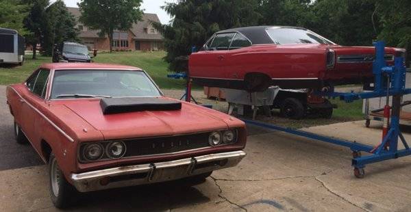

That looks great MTUCJ what scoop is that and how did you attach?
It was a used $20 piece I found at a swap meet - not sure of the brand. It has threaded rod in about 8 places to bolt it to the hood.
