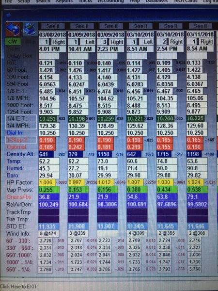

Here is the data. Pass 4 and 6 are the anomalies. The predictions and the hand math show the car to be right where I need it. The car just sets sail on the back half of the track.
PLEASE, PLEASE, PLEASE share with us what kinda of DATA Program is that....I love it....I need it....
Crew chief pro is the data program. It’s not cheap but when you race from Florida to Georgia to Kentucky to Chicago to Norwalk to Indy and then a bunch of bracket races and nostalgia events in between... it pays for itself from analyzing weather and comparing predictions for qualifying. Just to give you an idea of what it’s come to. After round one of qualifying in nostalgia super stock in Bradenton, Florida I was number 6 with 10.259. So .009 over was only good for number 6 in the first session.
