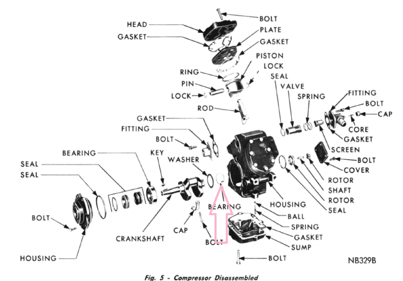

Hello all I'm slowly collecting the parts to rebuild my V2 A/C compressor but I'm a bit confused as to how many bearings are on the crank shaft according to my 69 parts book (illustration) it has 2 bearings both numbered 24-25-160 but when you look up that number it only shows one bearing number 2019681. i already have 1 of those bearings which only fits the front of the crank shaft & not on the rear so what am i missing ? am i reading the parts book correctly

I'm not seeing the rear bearing listed or am i missing it

okay thanks but not the bearing i'm inquiring about i'm looking for the bearing pictured in the compressor break down for the back of the crank shaft with the pink arrow pointing at it
Read post #2 above. I gave you the number.

Yes the clutch bearing is way up front with the belts. The front compressor crankshaft bearing is 2019681 and the rear crankshaft bearing is 1994152. Both are shown in the factory parts manual.

Thanks i knew that's what you said originally but the front clutch bearing got thrown into the mix somehow which fried my brain . i've done a web search & still unable to find any matching bearings for that 1994152 number even on the the link you provided, is there any other interchangeable part numbers that replace that bearing thanks again
I am not sure on that number if is was superseded or not. You might try a company that rebuilds them. Is there a number on your old bearing? Mopar numbers and actual bearing numbers are not the same. Finding a bearing number may do the trick. I had about 6 of those old compressors that went for scrap.
