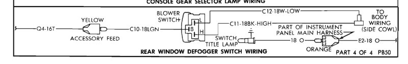

Anyone have a photograph of under the dash that reveals where the wiring goes for the air grabber light and solenoid? There is a three terminal orange female connector under there and I wonder if that is for some of these wires? Same question for the rear window defroster switch.
Thanks!
The illumination light leads for both switches connect to the orange three-way tap to the driver’s side of the harness, near the switches. The A/G solenoid green and the light green rear window blower switch wires connect to the ACC three-way tap (Yellow) near the radio.
That is perfect. thanks for the information and quick response!
