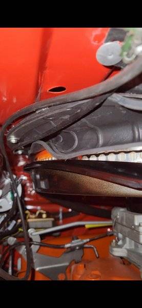

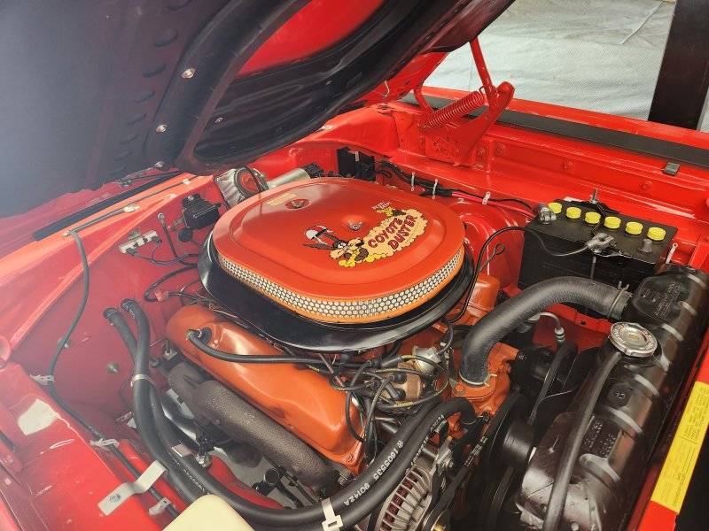

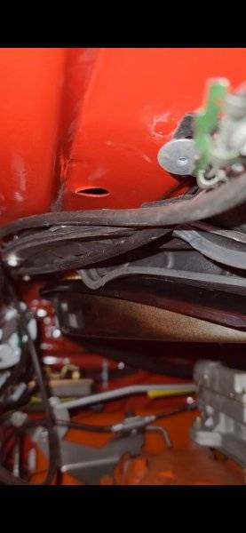

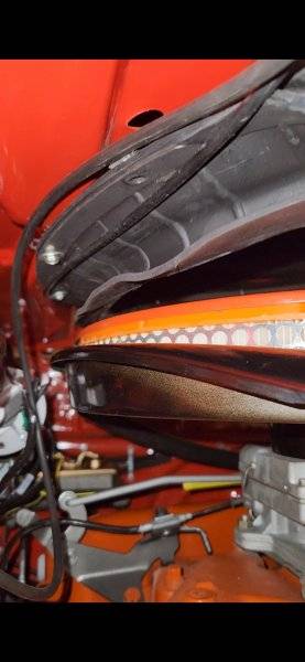

I recently finished restoration on my 1969 roadrunner. I purchased an air grabber seal / gasket for the duct to base from Detroit Muscle tech. My issue is the seal is bunching up on rear of the air cleaner lid and putting a lot of pressure on the original plastic ductwork and raising the center of my hood up about 3/8". This is a pretty much stock application from original Carb, air cleaner base, intake, gasket sizes, ductwork, etc.. I tried moving the seal rearward as much as I could. Anyone have this issue and resolve it?

I have not resolved it. Unfortunately, it is still the same way. I spoke with the Manufacture, about 6 months ago and he assured me that they were going to look into it. He did say that the seal was made to original specs. I tried everything I could to get the hood seal to go more towards the firewall when closed but at the end of it the I.D. of the seal is only 3/8"-1/2" larger than the O.D. of the lid, that's fine for side to side but when closing the hood front to back and coming down at an angle, it needs more room at the rear of the seal to clear the lid.

Another thing to verify (hopefully I didn't miss this in earlier posts): Are you using a factory intake manifold? An aftermarket manifold is likely taller than the stock unit. Honestly, I find it unlikely that a poorly manufactured seal would cause these issues. Either way, I think you need to verify which issue you have. It would be good to do some measuring to verify where your base plate sits when the hood is closed. One way to get a decent look is to set up your cell phone under the hood and take a video. Of course there are many other possible ways to measure, but I think doing so is important so you can get this issue resolved. Likely it is best to do this without any seal installed so you can see and measure the gap.

For those of you still following this post I am trying to fix this problem as well. I did order another seal from Detroit Muscle and it got slightly better. I put a jack under the transmission and again it got slightly better. My biggest problem I think I have is the stack height of the carb. I have a carb with with a gasket, 1/4” spacer and a gasket. This puts the height about 3/8” taller than the factory set up.

From what I read and see this is 1969 383 4bbl. RR with N96 airgrabber, the large oval lid and filter is correct in this application. I would think the problem may be in the engine angle as stated early on in this post. If raising the rear of trans doesn't work/help then I've got nothing more to add. For a test do you know someone with a GTX so you could try his 440 base which is shorter and should also help you .

I installed a 1/4” shim between the transmission mount and the transmission. It changed the angle enough to push the air cleaner forward 3/16.
Purchased a new seal and made sure to roll the back part of the seal rearward before closing.
