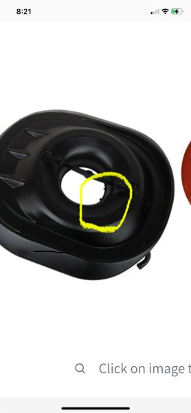

Just ordered a airgrabber base (69 440) it’s going on a 440 with a holley dp carb. These 2 tabs in the carb mount base I have circled don’t allow it to sit flush on carb do you bend them up? Looks like they are meant to line it up straight but not not on a Holley?
Bend them up or cut them off. Can't remember which I did.
They don't fit anything but a stock carb !! The purpose is to keep the base straight front to back.

Have no issues with my Holley but using original base and 70-72 base
