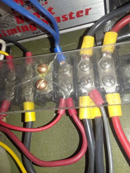

and field wire, Right? Is that normally a dark blue wire ? Here is a pic of the blue wire, coming off the regulator, and going to a junction. It is showing slightly lower voltage,with key on, than what i measured directly off the battery .

As for the "field wire" voltage, NO that is the output of the voltage regulator, not the input and it should not be the same. Check the terminal on the voltage regulator that is labeled "BAT", this is the battery reference voltage INTO the regulator. This is the voltage that SHOULD be the same or very nearly the same as the voltage measured right at the battery positive terminal. Any difference in voltage between these two would indicate "voltage drop" in the wiring, connections, and/or ignition switch prior to the voltage regulator.
