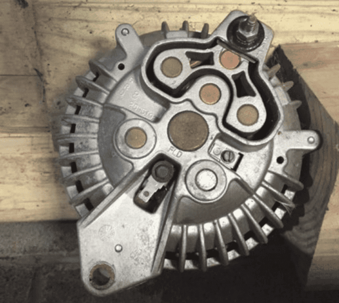

the rusty circle in the center of this photo is the rear armature bearing. It becomes magnetic when the alternator is being spun by the running motor and a field test is to touch some steel to it. Take care to not touch anything else.
I was always told the same thing. If the alternator was working correctly, you could feel magnetism at the back of the shaft.
